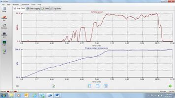

If you see your actual coolant temp is pretty close to 200 degrees f, I would drive and be happy.
here is a screen from a drive I took last year. you can see i fussed a bit with the computer attached before taking off. and the temp went from 60 to around 200 and stayed pretty much between 200 and 210.
given you had overheated the engine, I would want to find a way to measure the coolant temp, or replace the temp sensor. you need the temp as coolant leaves the thermostat.
for reference, I replaced the thermostat a few months before this, was running cool. I still have the original sensor, after ten years and just under 150,000 miles.
I use my laptop (my cell phone barely takes pictures) with obdwiz software and obdlink SX cable from scantool.net I also invested in Scan XL software, and a GM package which reads more codes not in the generic OBD set.
you may want to check out https://itunes.apple.com/us/app/dashcommand-obd-ii-gauge-dashboards/id321293183?mt=8
kind of pricy. probably cheaper alternatives in the apple app store.
