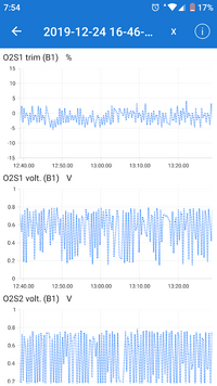

My 02 Bravada is throwing a P420. Live data for the oxygen sensors show sensor "mirroring" where both sensors follow the same trend. it still does 19 mpg on highway and I don't think I have any issues with reduced power.
1) How do I know if the catalytic converter is bad or clogged, or of the oxygen sensor is bad
2) What engine problems can cause the cat to die on the 4.2L vortec?
3) Can I cut the old cat out and just clamp a new one on?

Based on the posted o2 response traces, it would appear that your cat is shot. :-( If the downstream sensor was "bad", it would be unlikely that it would be switching at any rate. Having said that, you need to provide more information about what the trace actually is.... is this at idle? If so what happens at 1500 rpm? Further, how long was the engine running before the trace was captured? You need to ensure a warm engine condition so that the sensors can be at "operating points". Next what software are you using to capture the info? Lastly, what is the history of the vehicle / engine? Just saying that you get good mileage doesn't really mean much. Posting fuel trim info that coincides with the traces will also provide useful information. Further on vehicle history, what is the status of your coolant?
Yes the picture is at idle. At 2500 RPM, the bands get closer, but they still follow the same trend. The engine was at temp and I was driving for about 30 minutes on the highway. Engine has 235,000 miles (I think it's the original), and coolant is brand new dexcool (I switched from regular recently). Software is car scanner pro, very good software. Here's the short term fuel trim after driving for 20 minutes.

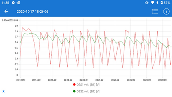

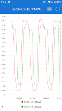

UPDATE
Since we don't have smog or inspections in Iowa and my CAT is not clogged, I got me one of those eBay O2 extenders (basically a non-fouler) and mounted the downstream O2 sensor on it.
Before:
After:
M18x1.5
No P0420 code have come back yet.

My cat will not light off at idle either, the downstream sensor mirrors the upstream. However at a cruise or slow city driving it will light off and the downstream sensor will turn flat.
It doesn't behave like this all the time, I generally get a mirrored waveform on the downstream but at a much lower intensity, more like a slight sawtooth waveform.
I'm sure it's needing replacement, but still hanging in there.
