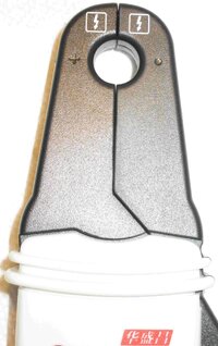

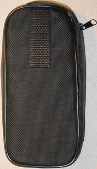

For the sake of @Elizabetty and in recognition of her recent enormous efforts of "Trying to Run Electrical Goblins to GROUND...." I'm following up with the Un-Boxing Images of the CEM DT-337 Low Amp Clamp Kit I ordered back on January 19th, 2023 and which only just arrived on Wednesday, February 15th, 2023 from China to encourage getting THIS Device.
I won't belabor "HOW TO USE THIS INEXPENSIVE LOW AMP CLAMP". But instead, suffice it to say, anyone who spends a few minutes Reviewing ALL of the Videos Linked up in Post #1 will be able to glean the best ways to take great advantage of so much Low Amperage Parasitic Electrical Draw Diagnostic capabilities in such a small, inexpensive package:
