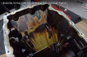

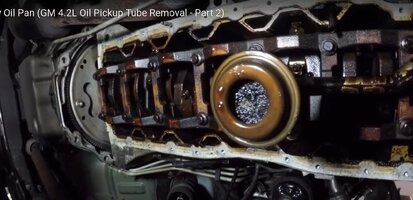

However... If the Oil Pump Pick-Up Tube "O"-Ring was either Cut or Compromised... The end results of this effort would prove moot.
Ordinarily, all of this work is necessary in order to access the likely suspect of having a COMPLETELY CLOGGED OIL PICK UP TUBE or a Damaged "O" Ring. My suggestion back then was to consider trying out this "Passive-Aggressive Chemical Approach" as a Last Ditch - Desperation Effort by first Draining the Old Motor Oil, then Replacing the Old Oil Filter and then Over-Filling The Crankcase with Berryman's Chem-Dip for an extended period of Passive Soaking.

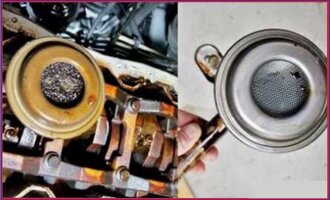

THIS Before and After Captured Image from the Video above shows just how effective this Berryman's ChemDip Passive Chemical Cleaning Solvent is and the Suggested Procedures for its copious use follow on:

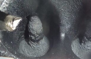

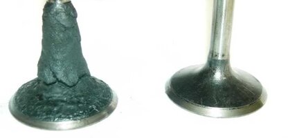

For "The Doubters" who can't imagine that 'mere chemistry' would actually be capable of bringing back the "Factory New" State of Cleanliness... Just observe what is covered in THIS Video:
...and View the VOP's prior post about Cleaning Pistons using the Same Method of extended submergence in Berryman's ChemDip:

If you look closely below at Kevin Nadeau's Side By Side Image...you'll see that Actual Large Chunks of Carbon Blow-By matter that have previously congealed and collected have vibrated loose and Fallen into the Bottom of the Reservoir. This Junk is just waiting for the eventuality of getting Sucked Into the Screen and eventually get much of it collected within the Fan-Folds of the Average Oil Filter. The Largest Pieces can form a sort of "Log Jam" for other Goopy Debris to stick to, aided by the presence of the Blow-By Gas Gum and Black Carbon to act upon that screen and adhere like "Glue":
Take Special Notice of the various "Cleaned Off" spots along the Bottom Rail Edges of the Crankshaft Cradle... THOSE Long Pieces of Carbon Mung Fell OFF and dropped down inside of the Crank Case:
THIS is the Hardened Carbon Debris you'll occasionally see if you Open Up your own Oil Filter and wash out in between the Fan-Fold Crevices ...it often looks like Black Coffee Grounds. So without allowing the Berryman's to actually fill up the entire space inside that reaches from the upper edges of the Oil Pan on down to the Very Bottom, then dissolving that Awful Collection of Black Carbon Mung... becomes quite impossible.
As you can see from this image of the SAME Oil Pan that the depicted Oil Pick Up Tube was removed from how this Black Junk collects and then Flakes Off ...dropping down into the bottom of the Reservoir to do its Mischief:

So thanks to the Chem-Dip process, MRRSM, and the members of this group, I'm a hero.
Thanks again for the good advice.

Very Glad to find this out! Now... Since the Dash board IPC Oil Pressure Gauge provides only a FAKE READ OUT... unless you were observing a TRUE Analog Oil Pressure Gauge as per these images and the information nested in Post #6 in THIS Thread..: Created by @MAY03LT :
This is Part 2 of his Two Part Youtube Videos on "FAKE OPG in the Trailblazers"
Then alternatively... You will want to install such a gauge as Described and Identified in Detail in THESE Images...using an AUTO-METER Special Adapter allowing you install and route the Oil Line coming from the Oil Filter Manifold and route it vertically and then across the Engine to the area between the Hood and the Windshield using a FLEXIBLE NYLON HOSE and place the Gauge in a position you can observe while Driving to confirm the Oil Pressure dynamically under varied Road Conditions and Engine RPM:

Another Member... @ZD3SF ... followed these Instructions and documented his own Successful "Step-By-Steps" in THIS related "On Topic" Thread using ACDelco TEC:
