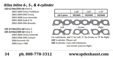

If these On Topic Sites have not been previously “Discovered... and ...Covered” elsewhere in this Thread... I thought @Capote would appreciate viewing these sources showing some interesting Intake manifold Material fabrications and Designs needed to build portions of the Turbo-Charger System for the GM Atlas Vortec LL8 4,2L Engine:
https://www.theturboforums.com/threads/vortec-4200-l6-turbo-build.372350/
...and when the time comes to Fabricate the Exhaust Hardware and Headers properly designed and built for the Turbocharger(s) on the LL8 Engine Platform… This company called “SPDEXHAUST” … makes Custom Headers and a wide array of Mix and Match Exhaust Components to Order as required:
http://www.spdexhaust.com
Here is the Link to their Latest PDF Catalog:
http://www.spdexhaust.com/pdfs/2018 Catalog with May 1, 2018 Price Sheet.pdf
Here is an example of their available "Ready to Weld" Exhaust Manifold and Header Flange Options for the GM LL8 4.2L Engine:
http://www.spdexhaust.com/pdfs/HeadFlanges/Vortec_4200.pdf
You can NEVER have enough resources to review for such an Ambitious Project as THIS One.

Much appreciated buddy.
