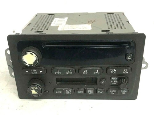

Can you take a pic of your radio. It will be a LOT cheaper to just throw in a OEM radio. I know none of the spare radios I have would work (all BOSE). But I can generally find unlocked radios pretty reasonable.
I hear you and for interest here it is. Mind you, I already decided that I would like one of those new units with rearview camera and bluetooth connectivity for my phone, so this is a good opportunity to do this.radio.jpg
