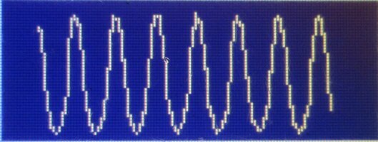

And for an "In-Depth" Professional Shop's VSS Diagnostic, courtesy the Snap-On Vantage-Pro Lab-Scope, Graphing Dual Multi-Meter and Component Testing Procedures approach... have a look at these images for some additional functional information and Testing Regimen to follow.
Mind you, some of them are "rendered just a little bit akimbo..." because I had the Vantage Pro in my lap when I was using the digital camera to capture the Screens that are SPECIFIC to your 2004 GMC Sierra Crew-Cab. These should work across a wide range of Engine Displacements since the VSS for the 4L60E and 4L65E Transmissions are identical in form and function:
IMG_1677.JPGIMG_1678.JPGIMG_1679.JPGIMG_1680.JPGIMG_1681.JPGIMG_1682.JPGIMG_1683.JPGIMG_1685.JPGIMG_1686.JPGIMG_1687.JPGIMG_1688.JPGIMG_1689.JPGIMG_1690.JPGIMG_1691.JPGIMG_1692.JPGIMG_1693.JPGIMG_1694.JPGIMG_1695.JPGIMG_1696.JPGIMG_1697.JPG

I'm not a mechanic and I don't understand what these images are telling me. Still can't figure out why the transmission isn't shifting right!?
