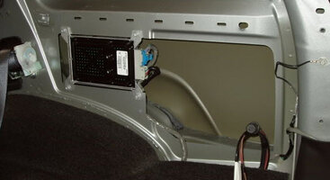

In a long wheelbase XL, it's in the left rear. Short wheelbase in the right rear. I think you just remove the seat belt mounting bolt with a large Torx driver, then the panel just unclips with snaps.
