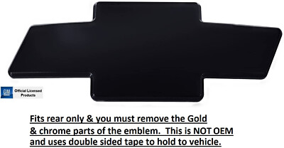

Found these black on fleaBay:
I would do the same to the rear. Paint over or carbon fibre applique.

The rear bowtie has two layers.
Maybe, but when I take off the soft gold bowtie, there's a chrome bowtie underneath.
It is also possible to color wrap the bowtie that has been peeled off.
There are no holes for screws, etc., so you can enjoy it just by polishing it.
