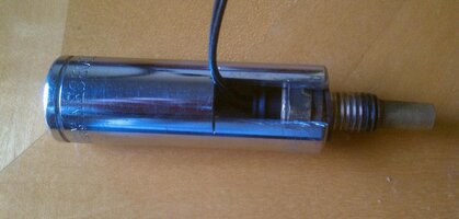

Blazinlow....the 10 min to cut this with a dremel or even quicker with a larger cutoff tool, will net you some sanity. Snap-on sells one for about $40 but if you have an extra 18MM deepwell laying around, I promise you it will be your friend.
Wanted to add, just remember to disconnect the sensor lead first.

Is the cut-away 18mm socket picture for replacing the coolant sensor?

Jumping in for gmcman, yeah the cut out socket is for the coolant sensor. Makes it into a O2 sensor like tool. If I have to do my coolant temp sensor again, I'm buying a cheap 18mm socket and taking my angle grinder to it.
I used a wrench, yes it was slow at 1/2 turn each time, but it saved me from cutting up a good socket!
