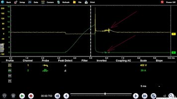

"What Am I LOOKING For in the COP Known Bad Wave Form?"
If you look at this Two Channel Ignition Wave Form Capture... Focus on the -=EXCESSIVE OSCILLATIONS=- occurring in the Tail End of the Yellow Secondary Wave Form Trace... There should ONLY be 3 to 5 Oscillations in that line (See the Red Arrows,,,?) showing that the Residual High Voltage is DISSIPATING:
Known GOOD COP Secondary Wave Form:

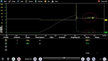

Whenever an issue with a FAILED GROUND to the Primary Coil Side of the COP occurs, these Two Comparison Wave Forms describe what happens when an Internally Shorted Coil in the Primary happens (Red is PRIMARY and Blue is SECONDARY). All Credit to ScannDanner.com:
Whenever there is NO PLACE TO GO for this High Electrical Power to Dissipate.. .it will HAMMER its way back inside the Primary Coil (Green Trace) and OVER-HEAT THE INNARDS and eventually Destroy the COP! Excessive In-Cylinder LEAN Fuel to AIR Conditions can cause this event to occur:
