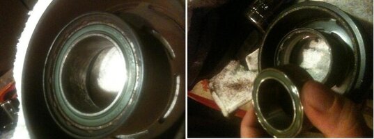

got the clutch off and the bearing out. To loosen the clutch bolt I took an open ended wrench jammed that into the hole in the frame to the right of the clutch and the closed end I turned the clutch till one of the big rivets caught the open end of the wrench.
The nut loosened pretty easily. I then took the snap ring out from looking under on the car as I was able to see directly into the ac unit with a flashlight in mouth. gotta love cree flashlights! small and bright as hell.
I then used a small 3 leg pulley I got at harbor freight. I ordered the bearing from autozone and knocked out the old one with a 33ish MM socket and a hammer. I grinded off the dimples first.
Here is the bearing, a 35x50x20.

I taped the old bearing to the new one and used a 4LB plastic sand hammer form harbor freight to bang in the new bearing hitting the old one. it started going in crooked so I banged it out and tried again. still a little crooked so tapped the higher side till it leveled out then hammered to the exact spot the original was in. There is a stop area where the bearing is being inserted I noted the original was not in all the way to it and put the new one to the same spot. I took a picture so I would remember.
I had to lightly hammer the bearing/wheel into the shaft/magnet all the way till I could see the ring clip area. got the ring clipped on from below. and tightened the bolt to the shaft...
at first I confused myself and used the SHIM as a washer, cuz u would think it was a washer, which caused the clutch to jam to the wheel... WRONG! I took the clutch off and put the SHIM on first! so it could SHIM! then the clutch and bolted it on.
I jammed a wrench into the frame and the closed end to one of the big rivets on the clutch to tighten it...
removed the bypass belt and installed the correct belt! turned on engine and QUIET!!! SO QUIET! see compressor spinning. and my twin electric fans! :smile:
and to make sure FRICTION isnt why it is spinning I turned off the AC and u see the clutch not moving!! SUCCESS!
