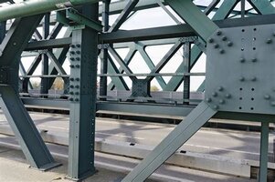

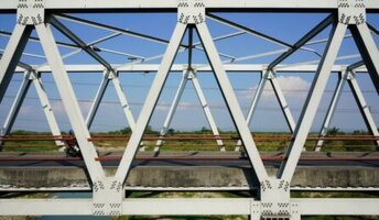

In general terms.. That area acts as a "Gusset" or a Structural Support Member that acts to "Strengthen by Triangulation". The concept here is that unlike a Square or a Rectangle in building ANYTHING... those two "Box" structures are subject to immediate collapse failures from Three Dimensions (X,Y,Z) ...into a flattened useless Two Dimensional Shape (X,Y)... Like a Cardboard Box!
In contrast...a Triangular Shaped Unit is held in both Tension AND Compression in All Three Vectors... rigidly Pulling AND Pushing ...simultaneously and is therefore almost fool-proof as a reliable support if designed in the correct shape and made of the correct materials that are used for any given structural demand.
The rounded (perimeter "Bulge") edged hole in the center is done for both Weight Saving and to prevent the metal from having Cracks Propagate and allow any Failure by having a Round -Like Radius around the hole with no weak spots.
In essence... those TB - Envoy Corner "Truss" units add strength and rigidity to an area that is subject to the "twisting moment" that can cause the auto frame to Flex and Bend during left and right hand turns when the frame is so seriously stressed and can become bent out of shape whenever changes in Torque and RPM are imparted by the Engine via the Motor and Transmission Mounts... and for those two spots...the Suspension Components, too... (Think of... Angular Momentum... as The Enemy) held only partly in check by Anti-Sway Bars.
If the GM Engineers did not think it was a necessity to have them ( L & R) in those particular locations... they would NOT have used *Gussets* in "The Build..."
th-1583851219.jpegView attachment 117281il_fullxfull.4685464222_qas2-2316617903.jpgGusset-compressed-446x260.jpg
