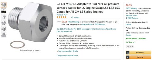

(B) Obtain an M16X1.5 to NPT Oil Line Adapter:
https://www.amazon.com/dp/B0894LDF76/?tag=gmtnation-20
(C) Obtain a Decent Analog Oil Pressure Test Kit:
(D) Check the Engine Oil Level FIRST and ADD Oil as needed. Then after removing the Hex Plug, Install the M16X1.5 to NPT Adapter AFTER wrapping some Teflon Tape around the Male Threads and slipping the Sealing Washer onto the Adapter. DO NOT USE EXCESSIVE FORCE TO INSTALL THIS THING INTO THE ENGINE BLOCK.
(E) Then Thread the Male 1/4" NPT End of the Oil Pressure Test Kit Hose into the Female portion of the Oil Gallery Plug Adapter after wrapping Teflon Tape around the Threads. Again....DO NOT OVER-TIGHTEN THE HOSE FITTING INTO THE ADAPTER.
