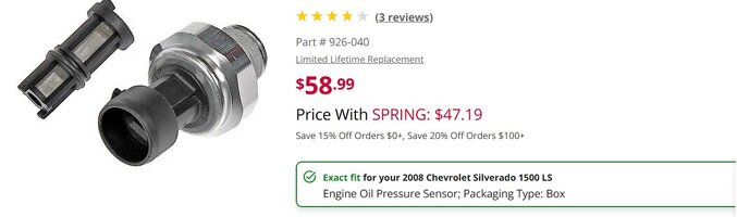

Seems odd, even advance auto states for the 4.8 with the screen

Mooseman
26,550
Ottawa, ON
I think it was replaced in the past by someone that got one of those sensors with the filter and figured to put it in anyway even if there wasn't one in there originally. It could be the reason for the pressure reading problems. If you check the parts listings on RA, some have it, most don't. Looking at the list of vehicles that the sensor with the filter fits, it even lists TrailBlazers all the way from 2003, prior to DOD/AFM and this filter even ever existing. It's a case of parts included that are not required for all models, kinda like rebuild kits where there are gaskets that are used on some years but not others.

Feb 14, 2023
41
USA
I took the screen back out, broke my left wrist doing it (slipped through the front end with my hand behind the intake) I think I will have to change the oil pump, it only happens now and then.
