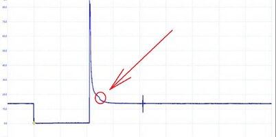

If you are fortunate enough to have and use either an inexpensive Hantek Model #1008C or a PICO-Scope Model # 2204A Oscilloscope to Diagnose the performance of your EFIs... THIS is what a Known, Good EFI Wave Form looks like as a Baseline for Comparison to your own.
Observe that Small Bump in the secondary portion of the Wave Form as it demonstrates the precise time that a properly functioning EFI Pintle Valve closes off the Fuel Spray. If THAT artifact is missing, or if the lead in Rectangular Primary Current Ramp is neither symmetrical nor having its Primary Spike image appearing "Tall" then you should suspect that you have a Failing #5 EFI:
