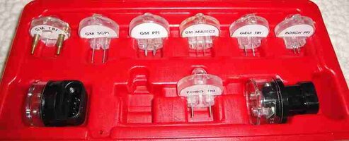

Check for an actual spark at that coil. If you have spark and compression, only one thing that would be missing is fuel. Check for power and trigger at the injector. A noid light (LED) works well for this. Another test is an injector balance test but this requires an advanced scan tool.
Roger That...
