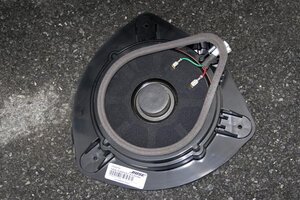

Stock bose front -
It looks like I have the yard stick out past on the right - it just looks that way so I could take the pic straight down.
What it looks like in it's 'pod'.

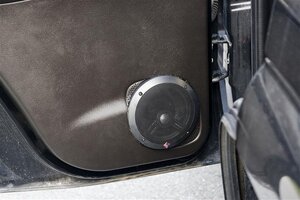

The rear speakers I would change to aftermarket without hesitation. I was also told 6.5's so I bought some and had to modify to get them in.
Here's a pic of what was in.
I couldn't get the pic where I wanted it - the bottom one is what was in.
My guess is a 5.25 would (ahh - might) fit but that's just a guess since this is what I did.
