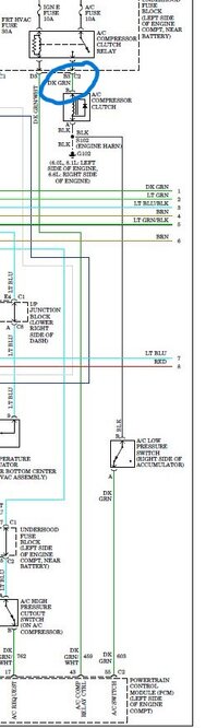

(1) The 2002 version is different in most of the writepus on this topic in that the e-fan relay & wiring harness requires a control input from what is cryptically referred to as the "A/C clutch trigger wire". I need clarification: does it mean the trigger wire for the A/C _clutch power relay_ or the A/C clutch _12V power wire_ going to the A/C clutch itself? I know GM can be pretty stupid about wiring color coding consistency, so I believe -- assuming it's the 12V power wire for the A/C clutch -- this is the dark green wire from the A/C clutch relay to the A/C clutch, like in the diagram below, not the dark green/white wire which triggers the relay - correct?
I know the DK/GN wire from the A/C clutch relay probably lives in the stock harness that goes by the red positive battery pole box to the left of the engine block. Is this correct? I also read there are several likewise-colored wires in the same harness, so I'd need to test for full 12V with the A/C clutch commanded to engage. (Or perhaps I should access the underhood relay center and tap directly below the respective relay's base?)

(on edit): Take a look at THIS page (although I have a feeling you may have seen it already). There's a pic a little more than halfway down that shows the wire they tapped from the harness by the red 'battery' box by the alternator. I'm pasting here for reference:
lighter
The issue I have is with the color description (schematic vs. their writeup) -- GM's 'dark green' is more like 'forest green', IMO. I also don't see any white stripe on this wire, but that doesn't necessarily mean it doesn't have one.
Thankfully, they describe the differences between the correct / incorrect wire, with +12v applied. Take a look and see if that doesn't get you closer to the solution.
(2nd edit): If you purchased the Nelson harness (and selected the 99-02 option), they may be able to help. Their installation instructions online (that I have a copy of) are specifically for the '03-up, but I'll guess that if they're selling different harnesses at the MY break, they'll know the best way to hook up the older one. Note that the guy there can be a bit mercurial, so if you reach out, it's better if you're an 'existing' customer, vs. a 'potential' one (just my observation, not from personal experience). If you've already ordered, and are pending shipment, they may (?) include instructions in the package. I can't remember whether my harness came with printed instructions, TBH.

Yes, I read the page you linked - it was actually one of the first I studied when I began researching this mod.
It's kinda iffing me out they didn't pinpoint which wire specifically provides the A/C clutch power from the power relay that lives the UEC, but I believe there's a workaround. (Tho the idea of pinpointing with a multimeter is pretty neat).
Instead of going for the harness next to the red battery positive terminal box, someone simply opened the UEC cover and accessed the relay/fuse base panel underside. By locating the A/C compressor clutch relay in the UEC, you just flip the relay/fuse base panel over and look at the wiring coming out from the sector occupied by the relay, referring to the relay pinout. The power wire for the A/C clutch that comes out from the relay base there is dark green (or forest green, if you like), and carries the 'heavy amps' to engage the clutch.
I've seen some other writeups and as far as the year 2002 units are concerned, the dark green/white stripe wire is the trigger voltage input for the A/C clutch relay; I don't think it makes sense using that, as the amps might be too low to drive the e-fan harness relays.
Tapping into the wire right in the UEC also seems to be more neat and safer, at least for me. I hate wire taps, they cause problems over the years, even if confined to the cabin (it doesn't protect from issues like humidity from wet carpet, some rain getting in through an open door/window, or snow brought in on the shoes). I don't know if the wire tap provided with the Nelson harness is weather-sealed, my guess it's not. Anything that goes extra in terms of wiring or splices under my hood deserves a marine heat shrink sleeve, period! :wink:

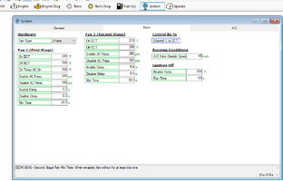

The PCM is readable wih HP Tuners and accepts the new settings file. Before I commit the 'first-final' settings... Well, yeah, I'm not sure about what is correct for some of the Fan tab parameters in HPT.

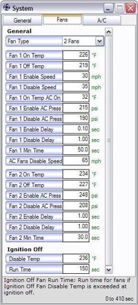

@Reprise posted his conservative settings in his e-fan thread, which look like this:
(Yes, I'm aware the settings are different from a '02 PCM, cuz his is a 2003+.)
What follows is the HPT settings of the PCM specific to a 2006 GMT with a non-Flexfuel 5.3 V8:
(The display in HPT here is different, as it was read by an older version of the software, but the parameters are here, despite a different layout.)
While desk-researching the parameters and differences between the manufacture years, I stumbled upon the settings for an almost the same PCM as mine (2002), but they are specific to a '02 Camaro:
All in all, most settings are very similar; the 2002 Camaro and 2006 GMT settings are bumped up a bit from what @Reprise used in his first tune for the mod.
Temperatures are a non-issue, but I know it's kind of better to go for values that are a tad higher; engines do not like running colder than they should, due to worse mileage and increased wear.
What bothers me - and here's where we're getting to what I need to now - is the differences between the Fan# Enable and Disable Pressure values across these three sets of PCM fan settings. The 2002 Camaro tune was said to work fine on the owner's truck (a 2002 GMT). The 2006 settings I posted here are stock for 2006 5.3 trucks and SUVs.
I just don't know which Enable and Disable AC Pressure values should be applied to my 2002 with dual A/C. Note that the 2002 doesn't use the 3-wire A/C pressure sensor that came with 2003+ models.
It's my understanding that without such a pressure sensor, the enable/disable pressure settings have no effect on e-fan operation.
