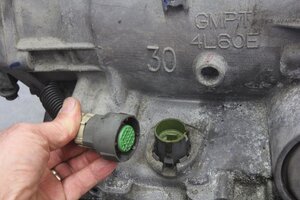

Visit Amazon and obtain a Can of CRC Electrical Spray Solvent (THIS Stuff can be sprayed to wet saturation and STILL allow for proper Non-Shorting Conductivity) and Spray out BOTH the Male and Female sides of this Connection:
CRC 05018 Lectra-Motive Electric Parts Cleaner - 19 Wt Oz.
(1) Locate THIS Plug and Remove IT:
(2) Thoroughly Spray out BOTH Sides and ALLOW TO DRY if possible.
(3) Plug the Gray-Green Connector Back In and Start the Vehicle ...AFTER... Removing the Negative Battery Cable for 30 Minutes prior to re-attachment.
(4) Clear the Codes and check for a better response...
(5) Fingers Crossed...
