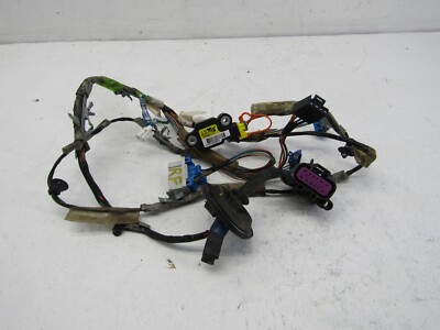

The wiring harnesses are fairly inexpensive over on eBay too..
Front Passenger Door with SRS wiring but no sensor..

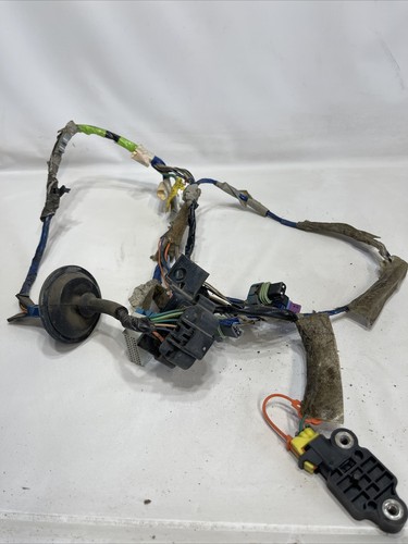

Front Passenger Door with SRS Sensor

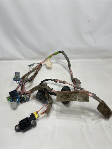

Rear Passenger Door
I cant find one... Which is odd, because I can find a Rear Drivers Door With Sensor! But no way to confirm if its the same wiring harness.

Yes there are sensors in each door.. It will be a yellow plug with a orange (usually) safety pin.
I can tell you from what research I have seen, that the door harnesses are kinda specific. 2002 it appears is by itself, 2003-2006 are the same, and 2007-2009 are the same.
