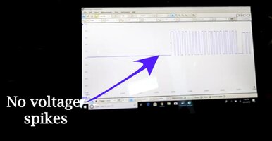

THAT Black Plastic Plug is the Central Ground Junction Point for the Class 2 Network System (Single Wire Network Ground)
DMMSPLICEPACKDIAGS1.jpgLATEMODELSPLICEPACK1.jpgLATEMODELSPLICEPACK2.jpgPICOSCOPECLASS2NETGOESHIGH.jpgPICOSCOPECLASS2NETGOESNORMAL.jpg
@MAY03LT Covers this quite nicely on the importance of this G201 - SP201 (Splice Pack)
