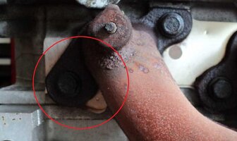

Often, when the Exhaust Manifold Bolts Snap Off... the Bolt Heads and upper Shanks will remain in the Exhaust Manifold Bolt Holes ...Stuck 'Tight as Two Ticks" (...not to Pull a Pun on you here...).
What happens after that is the remains of the OTHER side still threaded into the Engine Head will begin to Rust even more... leaving behind sort of a "Fried-Chicken-Brown" Golden Patina all over the adjacent MLS S/S EM Gasket.
Here are some closeups of what to look for. If you must replace more than just a few... do them in Pairs per each Port and Don't exceed 15 Foot Pounds of Torque on the Brand New 10.9 M8 X 1.25 X 30mm Fasteners:
Use a Bright Flashlight to search around for THESE artifacts:
...and once the EM and MLS Gasket are removed THIS is what can be found underneath:

Hey everyone I just saw this and on my way down to double check closely, also to double check oil and filter. Standby.....I have to ask I spent this morning recording the sound and I have a pretty good recording but question is can I post the video?
You can't post audio or video directly. You have to upload to YouTube or a shared drive and post the link.
Mooseman thanks I will figure out how to share it on YouTube. Ok I feel like an idiot idk how I didn’t see this first thing this morning when I ran it cold! I guess I didn’t have enough coffee yet or something!

Sorry MRRSM! Your absolutely right another upside down pic! Well I have another update, after inspecting the passages side closely to make sure everything was ok on that side I discovered the very back bolt head next to the firewall was missing. Also looking at the drivers side with a mirror I was able to determine that stud had sheered off up in the head say a thread or too, looks like I’ll have to try the welding trick and build up the stud to get it out. I can’t get a hood look at the stud on the passages side. More to come.

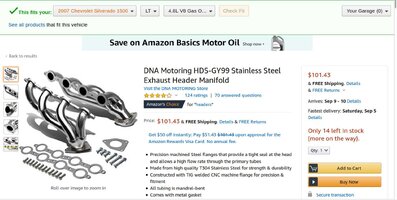

You might want to look over THESE Stainless Steel "Shorty" Headers for just over $100.00 as they are a Direct Bolt-Up Design, with COMPLETE 360 Degree Welds and consider the opportunity of eliminating the Rust and get a bit of *Bling* for your 4.8L Engine, all in the Same Go:
DNA2007SILVERADO48LHDRS.jpgDNA2007SILVERADO48LHDRS1.jpgDNA2007SILVERADO48LHDRS2.jpgDNA2007SILVERADO48LHDRS3.jpgDNA2007SILVERADO48LHDRS4.jpgDNA2007SILVERADO48LHDRS5.jpgDNA2007SILVERADO48LHDRS6.jpg
Reactions: gmcman and Mooseman
Reactions: gmcman and mrrsm
I wasn't just making the recommendation for considering getting these because of the Low Price. They are made out of the same 304L Stainless Steel that Elon Musk has chosen for the creation of his Starship Spacecraft. I OWN these Headers and can testify to their Low Cost AND High Quality:
