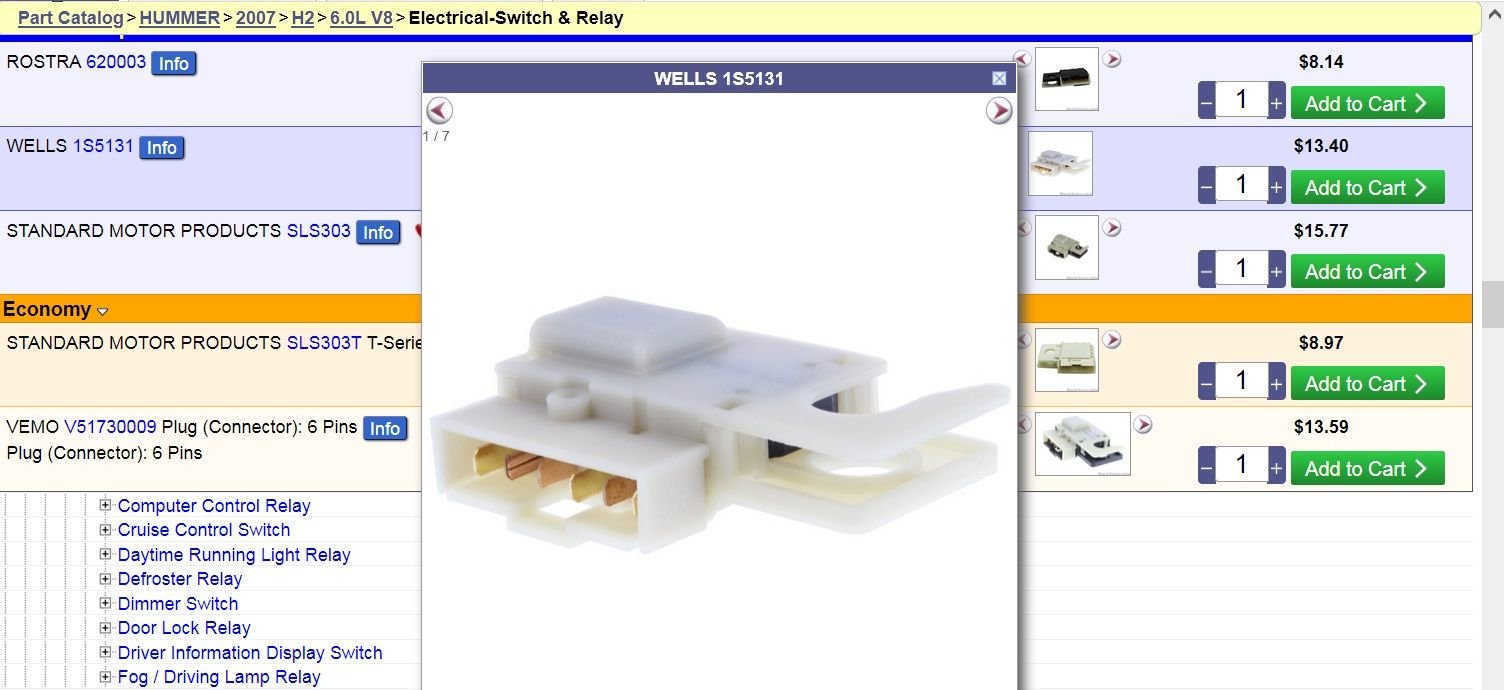

Is this what it looks like?image is it complicated mounting this plastic switch, I'm concerned I'd break it trying to attach.same part for a suburan an tahoe. thanks
thanks for tip on the charm.https://www.1aauto.com/how-to-replace-brake-light-switch-1999-2006-chevrolet-silverado-1500/video/64737
Looks right. But test it first to be sure that's what's causing your issues. Use the schematic.

the brakelight switch is indeed the same on the tahoe an the H2.I believe in 07 (mine) was changed to a differnt shaped switch however my 07 still uses the same switch as the earlier H2.
that switch will be very diffacult to replace.
