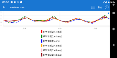

I dont really like the Torque app for monitoring. Is there another real time cylinder APP anyone can recommend?
Car Scanner has a nice facility for recording and graphing data. Saves everything you monitor so you can review it later. Just like Torque Pro you need to load PIDs for your vehicle. I have a file around for that somewhere.

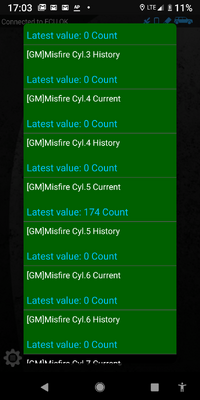

How complicated is it to add the "PID" for this ? From your screenshot Cyl #5 was having some issues. This would help me a LOT to trace this down i think.
So that screenshot was taken at the point where one is going to add a gauge to a dashboard. You hold down a blank spot on a dashboard and select "add display" . Then select the type of display. At that point Torque provides a listing of the available parameters with the ones currently reading appearing green. It was at that point I took the screenshot. You need to be already connected to the vehicle for the readings to show up.
The downside is that none of this is recorded or saved and truthfully itnis a pain to record stuff in Torque Pro.
Ok, and that is why I did not like the Torque Pro. It was hard to nail down REAL TIME stuff. Maybe I can just see it happen when the stumble occurs to pinpoint the issue down to the cylinder, but who knows. I'm going to see what the OBDlink adapter and APP shows me. It's crazy what you can do to BMW's with it.

I cannot recommend strongly enough that the Car Scanner app is far superior for logging data and catching intermittent issues. All you need do after setup is remember to start the recording. You don't need to, and shouldn't be watching an app while driving. The data is recorded right in the app and can be reviewed later in the built in graphing facility. Any misfires will be indicated in the recorded data.

Yes. That's the one. I have a file of PIDs for import to that app as well. It does not come with a set like the Torque program does but it can do most all of the PIDs in that set
