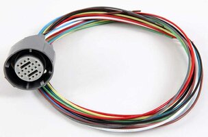

For information the 4L60E 20 Pin Plug Connector .... Here is a Color Wiring Diagram showing the PCM Pin-Outs:
The Red Circle Location is where the 20 Pin Plug is situated on the Passenger Side of the 4L60E Transmission. It only requires an "EZ PZ Squeezy" on the Two lined-knurled Flat Tabs ... then it lifts upwards... No Twisting Involved Here:
Replacement External 4L60E 20 Pin Connector and Pgtail Harness:
