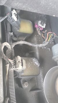

My suggestion would be a narrowing of the problem. Grab your camera phone, take a really good picture of your front fuse panel, or even multiple. Then pull every single fuse out of the fuse panel, including mega fuses. Just leaving the relays. Now put in that fuse that blows every time you turn on the ignition. Turn on the ignition. Did the fuse blow? If not, slowly, put 1 fuse in the fuse box at a time, waiting about a minute inbetween fuses. Sooner or later your going to find the circuit that causes the fuse to blow. If it did blow, you have reached the limit of my skill, unless its something related to the rear fuse panel, and you can perform the same process for that fuse panel.

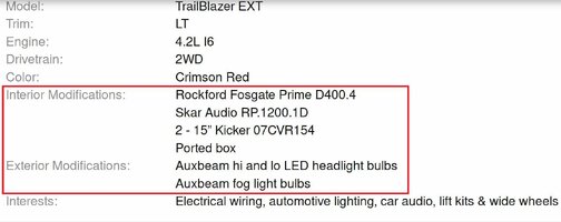

This may turn out to be a "Self Inflicted Wound":
Judging from all of your Mods... Taking ALL of them back down to "Zero" and trying to ensure that NO Electricity is feeding ANY of these AM Components would be a good place to Start:
I’m very experienced in installing car audio, I have completely disconnected everything aftermarket and nothing has changed, just like I had anticipated.

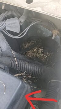

Rodents
These animals might be "The Culprits"...in particular the Genus and Species of the Ubiquitous "Deer Mouse":
These numerous animals can become more than a a mere nuisance from their incessant need to Chew, Gnaw and Wear Down their Endlessly Growing Incisors upon something like Insulated Wiring and Plastic Connectors. They can also become Quite Dangerous to Humans as they are the primary vectors and transmitters of the invariably fatal "Hanta Virus".
These rodents can form hidden nests under the hoods and engine nacelles and live in nearby wooded areas. On Cold Nights, they can climb up and inside of Engine Compartments in order to warm themselves on recently run Engines. In doing so, they can invariably Chew on the Wiring and also leave traces of the "Hanta Virus" in their desiccated Urine and Feces around these Nesting and Hiding Areas.
If these friable dried particles become disturbed and airborne... they can be inhaled into the Lungs and develop into a form of Hemorrhagic Fever that can KILL you. So Please... Mask and Glove up if you raise your Engine Hood and find traces and/or artifacts of their presence that look anything like THIS:
20200212_082334.jpg20200212_082029.jpg20200212_084141.jpgVideoCapture_20200212-083951.jpgVideoCapture_20200214-163628.jpg

Of course...just as indicated in your Profile... However, even with your understanding of these Electrical systems and capabilities of running Good Diagnostics and Repairs, if you either live in a Rural Area... or have only driven "Bertha" occasionally... Inexplicable Electrical problems might have an "external" cause that is 'plaguing' your electrical system that you might not ordinarily think about:
Rodents
View attachment 98738View attachment 98739View attachment 98741View attachment 98742View attachment 98743
That possibility has been bouncing around in my head as well, but I’ve been up, down, under, around, and inside everywhere I can possibly get to and haven’t found any evidence of mice. At this point I’d almost welcome that over whatever is actually going on ..

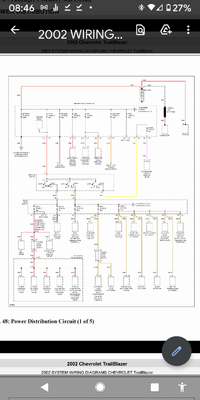

Yes I have downloaded what I hope is the correct wiring diagrams, and can see everything but can you help clarify things for me? Help nudge me into the right direction? I'm seeing in Figure 44 Power Distribution Circuit (3 of 5) Line G which i believe indicates the circuits that are energized when in the RUN position but I'm not seeing a 30A HVAC fuse until I flip to the next page, and that does not have the line marked "G" like the other one, so either I'm just too ignorant or I'm on the wrong diagram??
Seems like we are looking at different diagrams. Here is what I am seeing...
