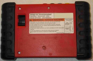

Here are some Images of the Kit that I finally 'Pulled The Pin' on and Got:
SANPONVANTAGE1.jpgSANPONVANTAGE01.jpgs-l1600.jpgs-l1600B.jpgs-l1600C.jpgs-l1600D.jpgs-l1600E.jpgs-l1600F.jpgs-l1600G.jpgs-l1600H.jpgs-l1600I.jpgs-l1600J.jpgs-l1600K.jpgs-l1600N.jpgs-l1600O.jpgs-l1600P.jpgs-l1600Q.jpg
***It would be very nice if there was a separate category or sub-listing for Diagnostics Tools that like these do, would focus on threads covering Oscilloscopes, their Accessory Attachments and Use other High End Diagnostic Meters in Kits like THIS one.***
Other than the Snap-On Full Color Probe Cable Set coming from Overseas... eBay Shipped just me this Kit in Record Time and this Gear was very thoughtfully packed, too.
By the way... THIS Graphing Meter-Device Runs Very Sweet (It Functions PERFECTLY, actually) on a Pair of Standard "D" Cell Batteries... :>)

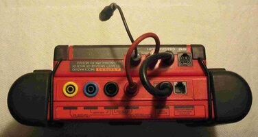

Here are the "Un-Boxing" Images:
SNAPONVANTAG1.jpegSNAPONVANTAG2.jpegSNAPONVANTAG3.jpegSNAPONVANTAG5.jpegSNAPONVANTAG6.jpegSNAPONVANTAG7.jpegSNAPONVANTAGE8.jpegSNAPONVANTAGE11.jpegSNAPONVANTAGE12.jpegSNAPONVANTAGE13.jpegSNAPONVANTAGE14.jpegSNAPONVANTAGE15.jpegSNAPONVANTAGE16.jpegSNAPONVANTAGE17.jpegSNAPONVANTAGE18.jpegSNAPONVANTAGE19.jpegSNAPONVANTAGE20.jpeg
EVERYTHING Necessary (including Extra High End Accessories NOT with the Basic Graphing Meter) is all present and accounted for in this Kit... and it ALL Works!

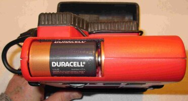

After discovering that the Two, Aging in-dwelling Dura-Cell "D" Size Batteries were of the "Old" Design (Smooth Copper Upper Jacket... Lines Free) I decided to order a New Pack of Batteries (With a 10 Year Shelf Life) and Replace them.
THIS is how the job gets done in just a few minutes:

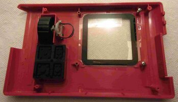

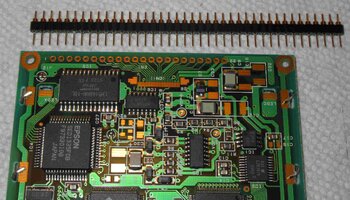

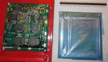

With this philosophy in mind, I ordered this Rare, Brand New LCD Screen and with S&H, it came to just over $200.00 with a pretty surprising FAST arrival time to my front door. In the 'in-between-time' prior to its arrival, I disassembled the Vantage MT2400 Meter for a Second Go:
But THIS time, I removed the Four Small Screws and separated the 4" Square LCD Screen from the Red Plastic Encasement Halves to get a better view of the 22 Female Header Pins meant to plug into the underlying Logic Board.
What has consequence for anyone else following suit with doing this same task is knowing that after I temporarily re-assembled everything... I discovered that the formerly Quite Dim Internal Light... was actually Glowing Nominally Well afterwards; ostensibly the result of me 'jostling' all of those 22 Pin Header Insert contact points onto and inside of the LOBO LCD Screen Socket:
The Moral of The Story should be to 'TRY Going The 'Dis-Assembly--Re-Assembly' Route FIRST' , unless you are like me ....and Unwilling to Do ANYTHING 'By Halves' and so you decide to 'Just Buy the Damned Replacement LCD Screen'... Outright.

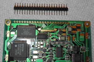

One other item of necessity is that the New LCD Screen comes WITHOUT (sans) having those OEM 22 Count X 2.54 X 2.50 X 6-8mm Long Gold-Plated LOBO PIns installed and properly Soldered In Place. So it will be necessary to spend another "Ten Bob" or so for a 10 Pack of these:
Then carefully Solder them into their respective LCD Board Holes after "snapping" off just 22 from any of the 40 Count Strips available on these "Peanut Brittle" - Like Pin Headers and slip the line of them with the Black Plastic Insulators positioned on the Underside of the LCD Board so the Pins Only appear Straight Up & Down on the LOBO Contact Side.

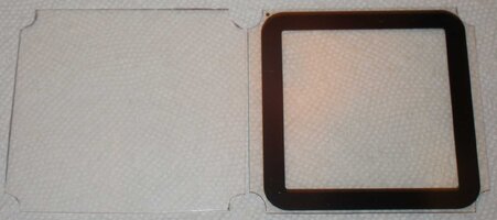

It follows that I also explored another point of concern I had with my Snap-On Vantage Graphing Meter in that the condition of the Plastic Screen Cover - LCD Protector was in need of some TLC... or if possible ...Replacement.
This was evident by the presence of some In-Shop Mal-Treatment with some Slight Dents and Cuts versus what should have been a "Clean Screen". But I knew that finding an OEM Plastic Replacement would be well nigh impossible.
The other issue was that the Screen Cover also bore a slight 'Yellow Cast"; much the same as experienced with ALL Poly-Acrylics Head Lamp Covers when exposed to a steady diet of Ultra-Violet Sun Light ...or even from the UV Light coming out of Shop Fluorescent Lamps.
So I scoured eBay and Amazon for some Plexi-Glas or Clear Lexan Sheets of Optical Quality and found a few thicknesses of around 12" X 12" X 0.030mm to experiment with. I probably could have Doubled the Thickness with NO Trouble installing inside of the Red Plastic Casement.
I got a kick out of one 'Amazon Buyer Dude' who complained that his Sheets arrived as "Bright Green" in color without realizing that they come with layers of Thin Protective Film on BOTH sides to assure they are not damaged in transit. :>)
These images Illustrate how I simply used the 'Sketchy' Original Plastic Cover as a 'Sketch' Template to make a Brand New One via Sharp Scissors and using some Black Gorilla Tape to simulate the Anti-Magnetic Strip decorating the edges of the OEM LCD Cover. It certainly DOES make a real difference once that Screen is finally "Crystal Clear" again:
Besides obtaining some alternative Gold-Plated 22 Pin Segments in a correct Length... I'm also waiting on the arrival of some 4" X 4" Firm Foam sections (with Single Sided "Stickum") to measure out and cut out a New Insulation Shock Absorbing Square Gasket.
That Item was meant to fill the space in between the outer edges of the LCD Screen Steel Frame and the Inside Space of the Red Plastic Case Fascia. The OEM version that was once tucked up inside of that space has long since crumbled and now it Turns To Powder at the Slightest Touch, leaving the New LCD Screen with no such protection...Yet... :>)

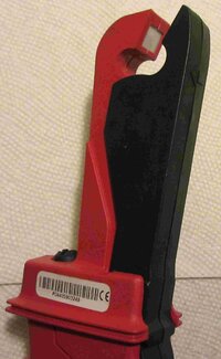

So... I've been lurking over on eBay for quite a while ...Hoping to find THIS Snap-On Model # EETA308A OEM Low Amp Current Clamp that is the COMPANION to THIS Graphing Multi-Meter after spying Eric "O" from South Main Auto using this device to very great effect while chasing down a Parasitic Drain on a Trailblazer from a good many years back.
This item is BRAND, SPANKING NEW and so it was NOT CHEAP... but nonetheless it is "The Pick Of The Litter" from among the very few candidates available for them over on eBay. This one was around $50.00 LESS EXPENSIVE vs. all the others that looked to be Very Well Used and "Shop Worn" . So... Wow! What an Absolute Compliment to this Snap-On Model # MT2400 Graphing Meter Kit ...
SNAPONLOWAMPCLAMP1.jpgSNAPONLOWAMPCLAMP2.jpgSNAPONLOWAMPCLAMP3.jpgSNAPONLOWAMPCLAMP5.jpgSNAPONLOWAMPCLAMP6.jpgSNAPONLOWAMPCLAMP7.jpgSNAPONLOWAMPCLAMP9.jpgSNAPONLOWAMPCLAMP10.jpgSNAPONLOWAMPCLAMP11.jpgSNAPONLOWAMPCLAMP12.jpg
Here ...See it 'In Action' for Yourselves:

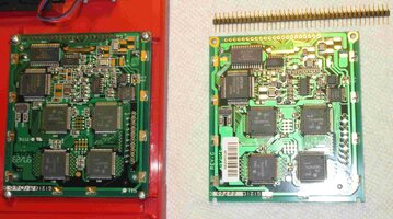

The Snap-On Vantage Version (5) 05-17-2002 Vintage Memory Card just arrived and after a Quick Swap with its Identical Vintage Brother... It Booted Up Normally and sailed through all of the Dynamic Screen Tabs and Special Settings with Flying Colors.
However... With having "Twins" of ANY Kind... The desire to make Close Comparisons between them is well nigh irresistible. And So... LOOK at what I discovered:

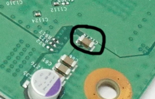

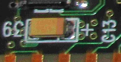

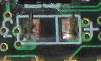

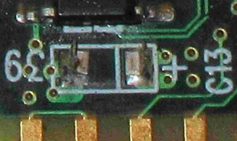

Note these Images of Two Distinct Surface Mount Components present on MY Original Card:
Now... View their identical Locations on the Second Card:
I suspect that all I would need to do is Probe the Two "Good Card" Locations to get their Values and then obtain a few of these diminutive things to play around with while performing SMD Repairs. I can use my Digital Microscope to get some very good close up visuals and then... Try my hand with my Soldering - Hot Air Work Station. As long as I don't get "The Coffee Wobbles"... this seems to be a very straightforward process and just might work.
I know that the 'Super Tiny' One must be a Resistor because it has no Polarity Indicator on the Logic Board Layout Box. However, the 'Larger' One (if you could call it that) DOES have a Polarity Requirement. So I'm guessing that it must be a Capacitor of some kind.
EDIT:
The Super Small One is apparently a "Ceramic Capacitor"
... and ... The Slightly Larger, Yellow Orange one is a "Tantalum Capacitor"
Hopefully, Our Electronics Experts here at GMTN will know better than I what these are, even without knowing their precise Values. There is no reason for me to rush in and 'MunKee Around' with anything just yet, as they BOTH still work... especially "The Good Card" :>)

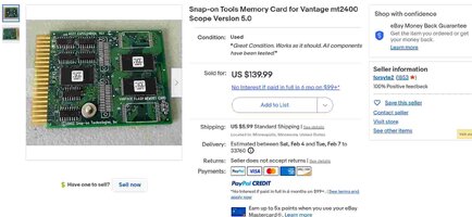

These are the eBay Vendors Two Original Photos for comparison. Most Likely... Rough, Careless Handling of this Card during its insertion and removal while being used in an busy Auto Shop Work Setting caused them both to literally get "scrubbed off" from their lightly soldered SMD Mounts atop the Logic Board. Note how they are positioned close to the Gold Tine Insert section on the upper and middle areas of this eBay card
So.... Why even bother with getting a 2nd Flash Memory Card?
Well... Because these Cards are Damned Near Impossible to Find Anymore, even on eBay.

Nice catch; good eyeballs! The larger one (C13) is an electrolytic capacitor; it has a specific polarity and orientation. The smaller one (C1) is a regular capacitor, no specific orientation. Looking at the closeup there appear to be fragments of C13 still stuck to the solder pads on the board (see outlines below). Also, it looks like someone may have tried to rework C13 previously as there appears to be residue on the left joint and, more tellingly,the former component's two solder leads are no longer parallel/colinear as you would see from an undisturbed part component. Are there any markings visible on C13 on the good board? C1 looks like it has been physically knocked off and but no repairs attempted. You are going to want to be careful when attempting to measure the capacitance of C1 & C13 in-situ on the board. This is especially important with C1 as it is tied directly to U1 (which, judging from the label, appears to be a custom memory chip containing operating code). Also, when handling these cards you need to be careful about ESD (electro-static discharge).
Thanks for looking things over...
Back on March 22, 2022, I posted the Dope on a $25.00 Digital Microscope I got so I could work on some of my Tag Heuer Model 4000 and Model 6000 Wrist Watches (See the Link Below) and THAT Kit was quite awesome as a Handy and Simple to Set Up USB Scope. I'll grab it along with a Bright Flashlight and clean up around those areas on the Logic Board sometime tomorrow with some 99% Alcohol and try to visualize any Component Factory Markings that can be seen on MY Flash Memory Board... and then We'll SEE What WE Can SEE...
Your Precautions are Echoed from this collection of comments about this issue as follows involving a Different Board... but posing similar difficulties and circumstances to what I am about to deal with:
"I've managed to break off an SMD ceramic 1206 capacitor of a motherboard I am working on, I'm am new to electronics, so be gentle! Anyway this damn capacitor has vanished into the place where all missing tiny components seem to go! I cannot find any schematics for the board to see what I need to replace. Good news is I have two boards, I need both, so no I cannot swap it out. So how do I test the capacitor to replace the missing one as there's no markings at all? I have a Multi-Meter only and it's basic Astro AI AM33D. Any advice would be very helpful! I've attached a photo sorry about the quality the parts are small."
“Your best bet will be to remove the capacitor from the second board and measure it there. You can find "smart tweezers" or other tools that can measure capacitance online. You cannot measure it while it is still on the board! Also, don't break off the caps or you will damage the cap and the board. You need its value, from a capacity-meter (Multi-Meter with this function) on the safe board (take it off, measure, & put it again) It looks like it's in parallel with the other 3 SMT capacitors (and maybe the electrolytic) so you might find it works without it (up to a point) then if you get problems, measure the DC voltage across those capacitors and choose a capacitor of the correct voltage rating and take a wild guess at its value (say 100 nF). Then see if any problems that might have happened turn to dust. Since capacitors are not typically marked, the only way to find the value is to measure them. You'll have to get a meter that can measure capacitance, take the corresponding capacitor off of the good board, measure its value, and then purchase a replacement that's the same size and value. Solder both capacitors back onto their respective boards. BTW, even without a scale for measurement, that looks a lot more like 0805 to me than 1206. There are plenty of cheap LCR tester kits on the market that can do this.”
Source:

Since removing "working" components off of the "working" Vantage Memory Card might wind up going 'sideways' and leave me without a "working" Snap-On Vantage Graphing Multi-Meter... 'A Bird in The Hand' ...approach here seems like a better way to go until I can slide the original VMC Board under a microscope and try to get the Part Numbers WITHOUT taking any unnecessary risks.
Off Topic but relevant your last comments ...and following that SMD Theme to a contemporary problem (which I have yet to solve and restore THIS Snap-On Vantage PCB)... if you would not mind taking a look at Post #7 through Post #11 over in THIS Thread and advise me on how to remedy THIS difficulty...I would appreciate the help:
As requested, I took a look at those posts. FWIW, I agree with everything @azswiss says in post #8.
I fear that I can't add much to the discussion, but I'll try...
Capacitor "C1" is probably a decoupling capacitor, given its position and proximity to U1. Honestly, I would not worry about replacing it. Plenty of folks (myself included) occasionally "break the rules" and leave off a decoupling capacitor in a temporary setup. And, unless you're semi-experienced at working with SMDs, you might cause more damage than good.
I'd be slightly more motivated to replace capacitor "C13", but maybe not to the point of risking further board damage, again, depending on your skills and confidence. I'd have expected "C13" to have some markings, but maybe they've faded. I don't have a microscope, but I've used an inexpensive 10x loupe to great advantage as my eyes slowly fail to focus over the years.
Is there any hint of marking on C13? Have you examined it under any magnification at all yet? (Forgive me if I missed something.)
If you do find a replacement for either of those capacitors and decide to solder a new part in place, be sure to use solder flux and solder braid to clean up the solder residue from the old part first, though.
I've never used a hot-air solder/re-work device, but if you know someone who has one since you have one, that might be a good option, for both removal of the capacitor(s) on the good board and installation of the new parts on the bad board.
Wish I had better advice. Hope that helps even a little. Whatever you decide, good luck!
EDIT: Just realized that you have a hot-air station! Corrected text above.
