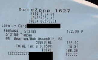

A word of warning- I wanted to buy a Timken hub when I had to replace one of mine over the summer. So I went to Autozone, the only place in my area that stocks Timken (according to their website). The reason being that I want a physical store location I can take it back if it fails in the warranty period. I'm also leery of ordering something from Amazon marketplace and being sent some knockoff ccc. The Autozone store didn't stock them and had to order it but it would only take a couple days to arrive. So I figured it was well worth the wait. Here is a picture of my receipt:
It's clearly labeled as a "513188 Timken Wheel bearing/ Hub". When I came back to the store to pick up my nice, new, shiny Timken hub, this is what they chucked on the counter in front of me:
Clearly NOT Timken. And the box is all crushed from being tossed around. When I asked them why it wasn't Timken their response was, "They are all the same." As I was naive, I accepted that maybe this was a rebranded Timken, so I took it home. Before even opening the box I searched around on the internet and found very little about this particular company. I didn't get a picture, but I believe it said "Made in Korea" on the bottom of it (maybe it was Vietnam or China, can't remember). I took it right back to Autozone and said, "Sorry, I ordered and paid for a Timken. I can't take this." After haggling with the guy I got my money back. This is the reason I WILL NOT return to Autozone. I think this experience was borderline bait and switch.
So the clerk messed up and grabbed the wrong part off the shelf. Happens all the time. Did they make good and get you the proper part?
If it was ordered and was on the shelf then they should have just grabbed the right part. Not sure why you asked for your money back?
I wish he had merely grabbed the wrong part. Remember that this store didn't actually stock them and had to order it from a warehouse so there wasn't a "wrong" part on the shelf to grab. This was what was sent for ordering the Timken hub. I don't think they actually carry Timken hubs anymore and it's just a vestigial part of their software. Even after I asked them about it, they said that was the "right" part. That's why I asked for my money back.

Incompetent retail sales personnel along with 3rd class manufacturing equates to many "pee'd-off" truck owners. :yes:

That's just f'd up. I can see how an order can get messed up in the database or inventory. But to have the clerk push it on you without a reason or price adj. is a big deal in retail. Probably something he could have gotten fired over. Did you speak to the store or district manager? I would be all over them if they did this to me.

The store manager was there and was the one that gave my money back. At first he tried to say that it was "just like" the Timken because it also came with a three year warranty. I told him that I didn't want to have to do the job again in six months or a year, even if the next new hub is a free replacement. It might be an isolated incident (I've had other smaller problems with this store) but something to be aware of when trying to get a Timken at Autozone.
