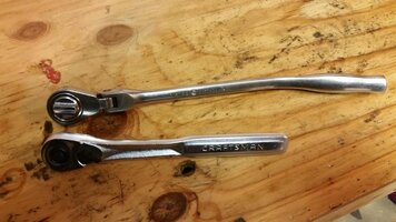

This is what I was pulling on, the amount of torque is significantly greater than what can be achieved on a shorter ratchet, so a regular sized one has less of a chance of breaking a plug than this one does. :thumbsup:
Edit: Plugs are pretty hard to break when you are using a spark plug socket, but its not impossible, like everyone else said, keep it strait. :yes:

That's a nice ratchet. It looks like it would come in handy for a lot of other things besides spark plugs. I too didn't know they had a ratchet specifically for spark plugs. I can see how it could help keep more of the force where it needs to be.

Tight spaces and it folds 90 degrees and it can be used like a screw driver. It's quite useful and it's older then me. (At least 20) it's a dual pawl and I believe it's 82 teeth, so in tight spaces you get a few clicks instead of just one or two. And the bend in the handle makes it nice to hold/work with.
