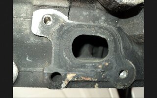

Your instincts about the engine having a Carbon Laden Mess in the Combustion Chambers might be closer to the mark due to the High Mileage on your engine then most would imagine possible. The empirical images I have attached shows just how bad the situation gets over time. With enough of the Carbon Build-Up present... it can increase the compression ratio in the combustion chambers enough to cause Lower Octane Fuel to detonate and raise Hell in the cylinders,
I hold an unpopular theory that if you remove all of the Spark Plugs and after bringing each Piston up close to TDC… by spraying in the Foaming GM Top Engine Cleaner, it WILL dissolve the carbon down into a Black Muck that would either have to suctioned out afterwards ...or simply stuff absorbent Low-Fiber Blue Shop Towels to absorb all the Goo when the engine is gradually being turned over to prevent Hydro-Locking the Motor. With a substantial amount of this stuff inside...the Carbon will be loosened and completely dissolves in an hour or so. The Top Sealing Compression Rings will be exposed to enough of the TEC to dissolve all of the Gummy Carbon sticking them in place and loosen up the Rings.
The important part of the problem though, is finding the means to snake a slender tube down through the Spark Plug Hole and remove as much of this mess as possible before cleaning the Plug Holes and re-installing the Spark Plugs. Please note that GM Top Engine Cleaner must NOT be put into the Gas Tank or pumped through the Fuel Injectors. GM has a very elaborate TSB that describes the need for “precisely measuring the amount of Special, High Octane Fuel mixed with an EXACT amount of TEC in a Ratio that MUST be...blah...blah...blah”.
The problem I have with all of those “BG-44” procedures is that these mixtures have to be BURNED in order to work... and having seen how well the Foaming Spray flavor of GM TEC dissolves the Carbon without lifting a finger while it works… is remarkable… but the application I used involved having pulled the Engine Head first, then Gorilla Taping up all the extraneous openings in the Old MLS Gasket and using it as a barrier while I filled up each cylinder with copious amounts of the stuff.
An hour or so later… all that Ultra-Stuck-On Hard Carbon Crap was literally melted down into a Black Soupy Pudding that I simply wiped off and absorbed and sopped up like Turkey Gravy with White Micro-Fiber Cloths. As a result... it was absolutely unnecessary to use anything that required either Harsh Abrasives or “Elbow Grease” to get then stuff off of the Piston Heads. It really works just that well. So to use this spray down inside a hidden combustion chamber would require the additional attention needed to extricate that Muck, lest it remain pooled on the tops of the Pistons and Lock the Engine up and bend the Connecting Rods into Pretzels as soon as the Engine is turned over.
I think that vacating the spark plug holes and using the absorbent towels would be insurance against that Danger when Turning the Motor Over… but you would probably want some additional means of actually sucking that crap out using a thin clear hose and a small Shop Vacuum … just to be certain. The Pistons came out so amazingly Clean and Spotless that they actually revealed their machining marks and casting stamp order numbers and directional arrows for installation as though they were Brand New!
There would be no room for error when performing this task… The pooling TEC will NOT run down past the Rings after the “foaminess” liquefies… nor carry away that Gunky Mess further down into the crankcase in any substantial amounts… but nonetheless...if you employ this procedure… changing the Engine Oil and Filter afterwards will be an absolute must because any contamination might compromise PTFE Oil Seals located at the Front and Back of the Engine ...and around the Viton-Teflon Valve Guide Seals in the upper Engine Head. In lieu of using GM Top Engine Cleaner… You might try THIS flavor of the TEC… as it has an Extra Long Plastic Hose for inducing the stuff directly into each combustion chamber… But… I cannot swear that it will be as efficacious as the GM product...which is Absolute DOPE! I cannot recommend these creative and unusual tactics to everyone… so I’m sure other Members will want to chime in with some related alternative ideas and different suggestions for better ways to perform this task:

Anyways, I am now almost certain that she has an exhaust problem. I took the exhaust off of hers again and started the vehicle. using the stethoscope, I listened to various places around the engine block and could not detect a knock. Holding her exhaust firmly and also making sure that the donut flange was secure and not rattling, I violently shook her exhaust back and forth and bingo! There is the sound that we have been hearing.
I don't know much of anything about exhaust systems, but there is a broken down material coming out of hers that looks like it fits in the enlarged cavity that I was pointing to in the video where I used the stethoscope. I will attach a couple of photos of the material I am getting out of the exhaust in this post. Maybe someone on here will know what this is and why it's coming out of the exhaust. It's right before the O2 sensor so I figure it's some kind of material to help emissions.IMG_2055.JPGIMG_2054.JPGIMG_2053.JPG

... and worth some extra "Bread" at any local Junk Yard, too. They recycle the Ceramic Honeycomb and Stainless Steel containers to reclaim the precious and rare earth metals... Platinum, Vanadium and Rhodium.. and will pay anywhere from $40 to $150 depending upon how much of that stuff is inside of those "innards". And as long as you bring along her vehicle title as proof of ownership before you set the old CAT on the counter, they will Pony up the Cash.
This video serves to "Show You the MONEY!" and explains the basic operations of CAT and why the rare earth metals are tucked inside of this clever "Gaseous Vapor Catalyzer" device. It is important to mention that in Basic Chemistry... when all of the chemical actions have been complete... You wind up with essentially the same amount of stable catalyzing metals that you started with ... and as such, they do not get consumed during the chemical transformations, retaining their elemental nature... and their value for reclamation.

Did I miss something....was the catalytic converter the culprit? If so that would be awesome.
holytornado84
Feb 21, 2013
111
Yeah I know. Awesome!!! Exactly what I thought as soon as I took the exhaust off of her car to try and put mine on there to see if the sound would be eliminated. I didn't even bother putting mine on because as soon as I shook hers and heard what was inside, I knew that that was our culprit.
I am probably going to go to a junkyard and find one with relatively low miles on it because the engine has such high miles anyways. Now I just have to wait on the harmonic balancer puller and installer to get here and I will be back at putting everything together.
