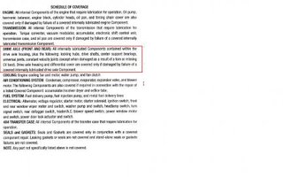

FYI - My extended warranty denied the axle replacement due to them stating that there was a rip in the boot which completly a completly wrong statement.

Wow guys.... Thanks so much for the extra insight here !! I can't believe the dealer didn't even realize this and neither did the inspector who came in to oversee the whole issue even after I showed them what I thought was wrong and even shook the whole axle just like in the video. I knew there was an issue since there is excessive movement in the whole CV shaft unit and also the extra vibration in the steering wheel and the occasional crack/metal sounding thumb from the right hand side of the TB. Would this be the cause of the sounds? Either way I am going to press this hard on both the dealer and the warranty company since I pushed them to reassess this issue and they still came back with, "All looks fine to me". I believe this part is covered since to me it's an internal component of the 4 wheel drive system. I've pasted a screen-print of my covered parts just for your viewing pleasure.
Again... I really thank you guys and appreciate this site !!:thumbsup:
