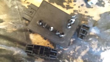

My driver's seat is not working. Will not travel on rail. I have removed the switch panel for a better look at things. Has anyone ever separated the knobs from the switches ?
I am trying to avoid breakage. Underside of seat is very clean. Thinking of pulling it. Is 70 lbs a reasonable guess as far as weight ?Seat Switch Panel -1 (Small).jpgSeat Switch Panel-2 (Small).jpg

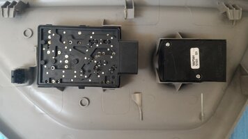

Yeah I've had mine apart before. I (carefully) pulled back the tabs which hold the switch in the panel, and popped the switch off of the panel which made the knobs pop off in the process. I think I have a spare sitting at my shop, if I do then tomorrow I'll post some pics of it knob-less.

Sorry for the late reply, here's the switch without knobs. And as others have said it does sound like it's not the switch.
